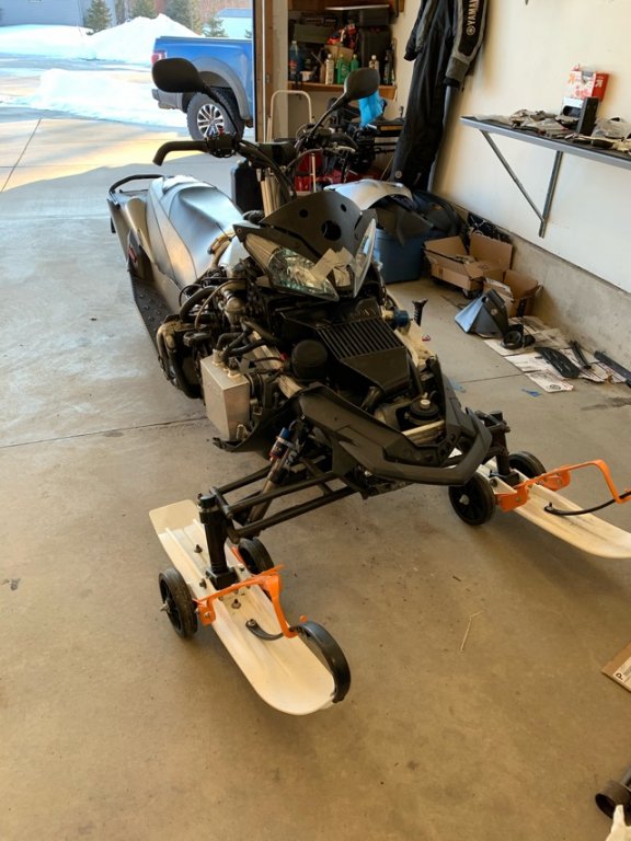

I actually replaced that hose. I just stuck a bunch of rtv over the crankcase bolt and allen bolt behind the clutch. Ill see if that helps.
Hose down that engine compartment with brake clean and spray foam that b@#$th up.

It’s actually leaking oil not coolant. Going to take it out for a run and see how bad it leaks and if I can just add oil each morning or not.

Went out for less then a mile and oil everywhere. Im throwing in the towel until summer. I’m thinking its a cracked block that opens up under pressure or something. Really a bummer but this sled will get a new full re-build this summer!
Just googled it. You are 8.5 hours away from me. Which means in less than 24 hour you could have a good known block. Swap out the piston and you are good to go.

Looking at getting back on this, I do have a new motor on the way but I would like to diagnose this better so when I pull it I know if I can sell it, part it out or what. I have started it and loaded it on the trailer multiple times this summer not a drop, as soon as I get over 6K and into some boost it actually sprays oil from a unknown source over there. NO oil is mixing with the coolant that was clean. I can't find any cracks on the case, or the water pump. Completely stumped!
Anyone have an idea to test before I render the sled un-usable and yank it?

I was out testing a turbo Apex a bunch of years back and had the day cut short by an oil leak. On this sled it was the fitting on the crankcase that the oil return hose clamps to. The fitting itself had come out of the block (I guess it is just a press fit from factory). Anyway, I cleaned up the fitting/case and put it back in with some red loctite, and the sled has been fine ever since. This is a bit different than your issue (one time failure vs. repeatable failure) and confidence is low that it's your problem, but still something you can look at that probably hasn't been checked yet.

you could check and see if the oil filter gasket has one stuck on from the time before...I had 2 oil filter gaskets on and it sprayed oil just like you describe and the picture looks...its worth a check. Joe

Thanks Jim, I will try to find that fitting. I have a brand new oil filter on it and triple dog checked the O ring. Could a cracked block spray oil over there? There is literally no hoses or anything that contain oil. So bizarre!

What is that designed hole on the waterpump smack in the middle of my oil trail?

most likely the weep hole for the coolant to indicate the seals have failed.
