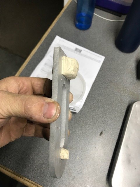

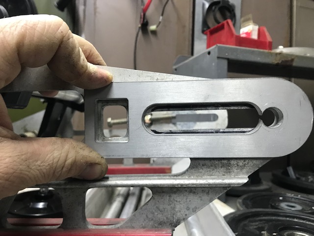

Been awhile since I posted anything on this. Some have raised concern of having to modify the rails, but reality is if you want to run a true 25mm axle the slot has to be enlarged. Below are a few pictures and I will explain my logic. I would like some feedback once you see what I'm proposing.
The rail adaptor plates will have track adjustment blocks integrated into them. The rail plate will likely be 1 machined billet piece as shown below. It would snap into the rail, self locating itself and would be fixed in place. Similar concept as a rail extension. I used some clay to depict the concept for photo below.
Once the plate is snapped in place you would then mark the new slot on the rail. Using a burr( which I would provide with the kit) you simply use an air tool or drill to enlarge the slot in the rail. The slot does not have to be perfect and can be oversized....it just needs to be opened so the axle can clear. Once you snap the rail plate on have a perfectly aligned slot and your grinding work is completely hidden. Its approximately 3.5 mm that need to be removed on top and bottom of slot.
Please provide some feedback so I can determine if this is worth pursuing. There are more details to sort out, but main thing I need to know is if you would consider modifying the rail.

I wonder if this jig would allow conversion to 19 axle and 6205 bearings?Been awhile since I posted anything on this. Some have raised concern of having to modify the rails, but reality is if you want to run a true 25mm axle the slot has to be enlarged. Below are a few pictures and I will explain my logic. I would like some feedback once you see what I'm proposing.

Ok...so not much feed back on modifying the rail. I'm going to assume many will no want to and going to move ahead with my plan B.
Plan B will still be a stronger option that utilizes a solid axle and no rail modifications. This option will also work as an upgrade kit and utilize all the wheels existing in the various 4th wheel kits on the market. Stay tuned. More details to follow soon!
