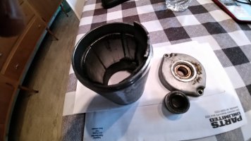

Well still having issues with starting and kickback. This morning did not want to turn over at all. Tested the battery after it was running and its only pulling 12.5-.7. Drain somewhere? Maybe regulator?

It was time for a new one. I think you'll be good after the replacement.Well I took the starter out and this is what I found. Few loose pieces inside. Hope that this is the issue. Have a new starter to install.
