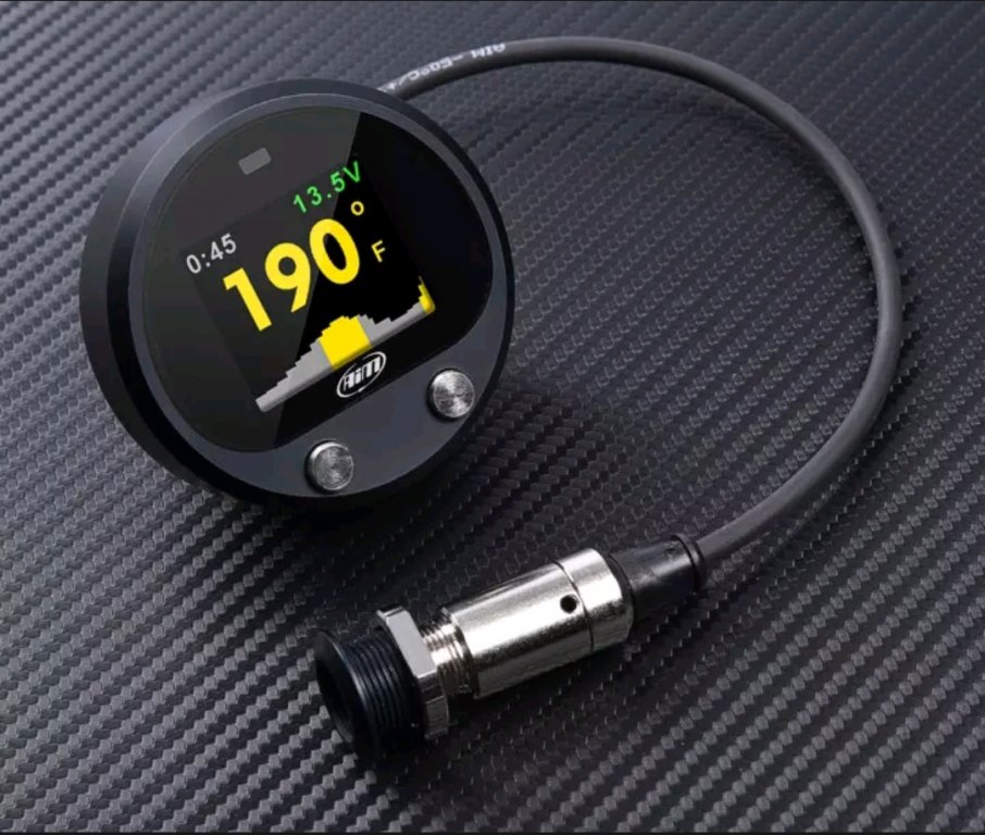

The AIM IBTS looks like another nice option too...
KnappAttack
- Feb 19, 2004
- 4,995
- 6,334
- Welch MN
- 2023 Sidewinder LTX-LE
2017 Sidewinder LTX-LE
The AIM IBTS looks like another nice option too... View attachment 164949
Thats a good looking gauge! Have you tried it in the cold weather yet?
