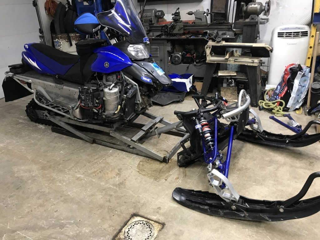

Digging in! Still can remove that front in half hr or less. Just glad daughter wasn’t hurt at all. Scary! Went right over and through windshield. Helmet junk not a scratch or bruise on her. We were so lucky.

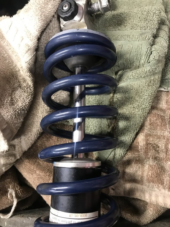

Shock shaft is bent and leaking

Yikes! Did one of those pesky Wisconsin trees jump out on front?
YupYikes! Did one of those pesky Wisconsin trees jump out on front?
If Spindle isn’t bent it will be a miracle.

I'm still waiting for my Phazer to suddenly spit me off into the trees. My last tree incident was 22 years ago on a ZR600. I was uninjured and the bent up a-arms still got me through the rest of the day somehow.
Looks like it might be possible to straighten it if there's no kinks. The grease zerks are a great add-on, I have to add those to mine this summer when I replace the bushings.
Good to hear no one ended up in the hospital.

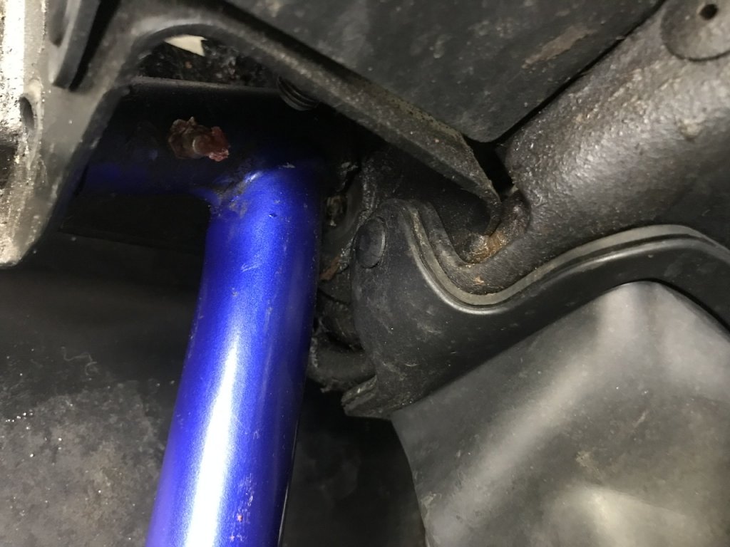

Thanks. Arm is bent bad at end but BOP fixed me up! Whole lot more grease points on inside. Everything is still tight God knows how many years later. Oh it wasnt the Phazer that spit her into tree. She just wasnt paying attention. Its been a common occurrence with youngest. Its really the best of times riding with her but I am going to take a different approach. Max speed 35 mph. Just like when I lead the club rides. I still enjoy it and as long as I can keep her from rear ending me it should limit incidents.I'm still waiting for my Phazer to suddenly spit me off into the trees. My last tree incident was 22 years ago on a ZR600. I was uninjured and the bent up a-arms still got me through the rest of the day somehow.
more at the front pivots you can’t see.
I did manage to straighten the shock shaft. So thats a big one off list. Will have to weld a washer to the front hole bolt goes through for a-arm. She got a bit egged and bent.

I would think you still will have some bend on the shaft, even if it looks good to your eye. Did you check it to see if it is still bent?
- 7,693
odds are he rolled it on a table with it all apart and masaged it back straight so it rolled smoothly. that is how i check/repair any bent shafts on my sled stuff and at work.
Yes that pic is bent. I still didn’t get it back together but it’s straight. Rolled on glass and indicated on Lathe.I would think you still will have some bend on the shaft, even if it looks good to your eye. Did you check it to see if it is still bent?
