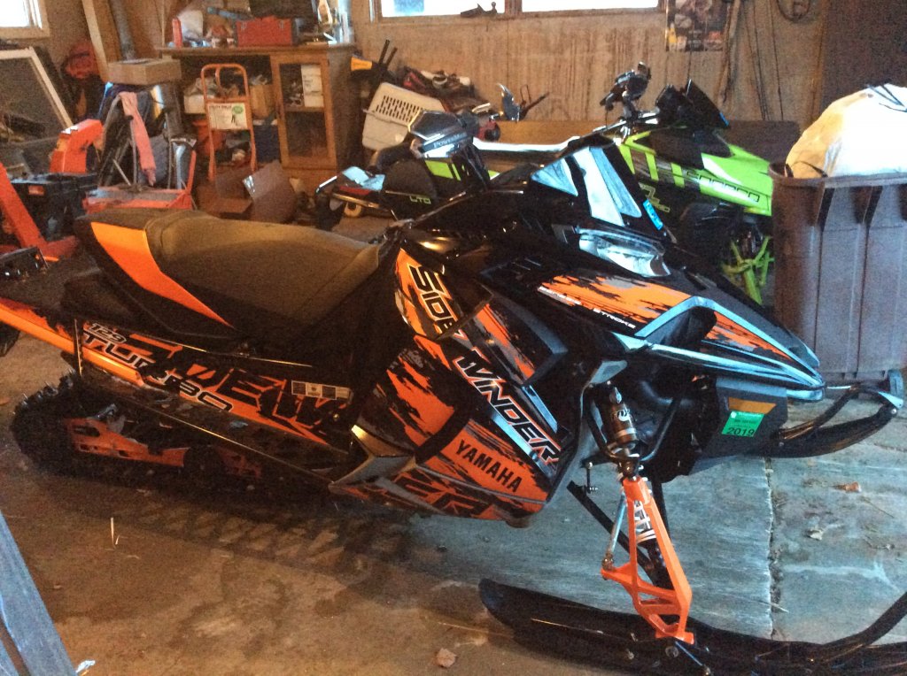

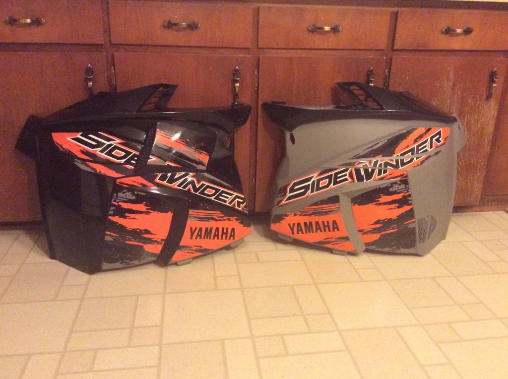

U got me thinking...now i am itching to do mine...looks awesome!!!
If you were to paint them, what kind of paint would you use on plastic? and would you just mask off the decals and paint around them?

You should email these pics to Yamaha HQ, very sharp looking sled.

Decals would have to come off. Paint wise, treat panels with adhesion promoter, then hi build primer, then sand smooth, then base coat with flex agent, then clear with flex agent.looks awesome!!!
sounds like vinyl is the way to go!!!
fyi , the panel knobs would scrape the paint off in that area
