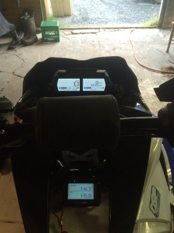

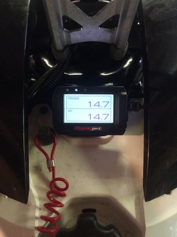

I am running the the pod-300 and a Wideband 2 connected to the PCV-PTI for AFR and boost. I picked up the boost tee after and I'm going to do the same as you said set it to just under 6 psi and leave it I'll take a picture when I finish the install of the gauge setup

Yes sir. She's beutiful. Very clean! Supa clean really.
Is that dyno jet gauge show boost and afr?

Yes it is, it's the POD-300. It looks good and lots of features

Does it plug in to the pcv?

Yes it uses a CAN cable and plugs in like all others pcv accessories. I have the Wideband 2 connected also that that's where my AFR comes from and the boost is right from the boost sensor on the PCV
