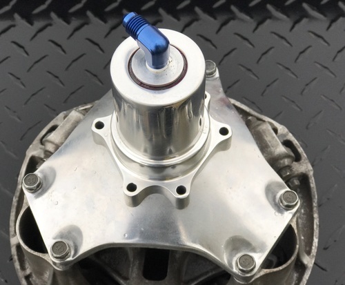

This is the hole shot blaster stutter will take me to 3900 rpms and hold me there to build boost and then this can be adjusted to any rpm higher than that to release the primary. Should be leaving the line at almost 300 hp.
