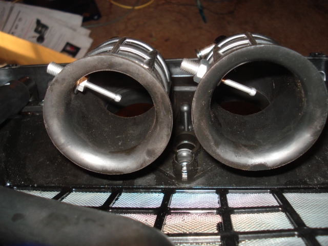

Hello all i picked up a used boss noss nitrous setup. I was looking at how i should mount the nitrous nozzles. Due to the shape of the phazer air box i figured i would try mounting the nozzles in the air horns. The nozzles i have are the straight thru design so i need to get a set of 90 deg ones . Iam just mocking things up. Do you think when the nitrous is flowing thru the nozzles cause the airhorn boot to flex to much? Iam going to get a bottle filled up when i get a chance and see what happens. Any feed back would be greatly appreciated.

i did my old apex set up the same way, just make sure they are in the middle and pointing straight down the throttle bodies when the air box is on. it looks like it will work fine the way you have it.
