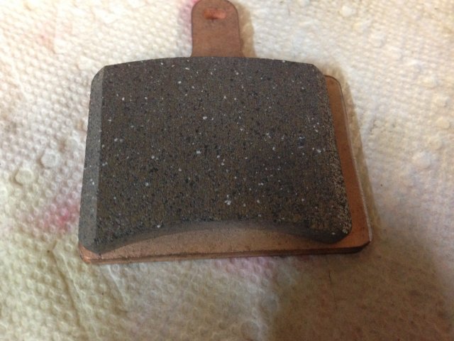

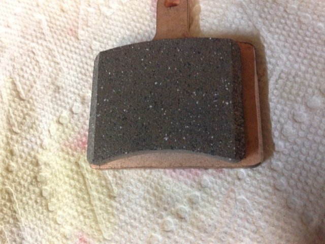

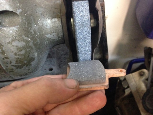

Some have asked how to fix brake squeal. I tried scuffing rotor and pads,coating they sell and even put race disc on. Squeal always came back eventually. This worked. Chamfer the edges.
As in sled:
Using grinder or even a file at about 45 deg angle:
Should look like this when done:
As in sled:
