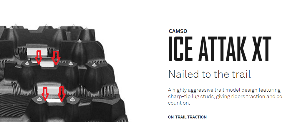

Just finished installing a Camso Ice Attak XT (pre studded), 1.2 lug on a 2013 Vector LTX. The skid isn't installed yet, so the track is sitting on the drive sprockets only by weight, but I find the the web between the lugs, in line with the clips rubs against the front tunnel tubing, about 2mm 's worth
Anyone else install this track on a LTX and come across this problem, or is just because the skid isn't installed yet, to pull the track tight?
Thoughts.
Thanks.

I have the question out to CAMSO Customer Service, but the sled track guy is out of the office until 15 May. I've asked if simply grinding away part of the web is an option.Great question ! I'm leaning towards this as a replacement track for my Vector ! Hopefully some one knows the answer ...

Ok, no issue. Tonight I pulled the track tight and back with a strap, and the track clears the square tubing on the front heat exchanger.

I haven't, as the XT has a lug height of 1.2 compared to the stock 1.25 lug. With the picks I'm about the same height as 1.25.
I guess I'll see next winter, but I'm pretty confident that I should be ok as the Web will hit the tunnel protectors, the way the track is designed.
