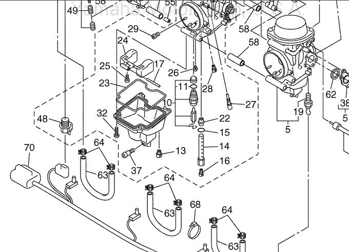

Pulled the carbs off both my sleds this week for their annual cleaning of the jets. The 05 has O-rings that seat into the bowls making the bowls difficult to remove when they dry out, my 03 does not have these, Any idea why they are there on the 04 and 05's? Anyone know if this is the correct part? I think part #49 in the 05rx1 picture is the part I need to order if I replace them just not sure if I need them. My 03 is much easier to get apart than the 05. As you can see from the pictures thats about the only difference I can see so guessing thats the part.

No part # on the bowl listed on the Yamaha Parts Listing (at least that I could find) shows the jets as being the same #. The only other difference I could see is part #14 (holder for the main jet) which has a slot cut into it for the O ring to sit in.
Think I'd get in trouble if I just took the deteriorated o-rings off next year when i pull it apart. All it does is create a seal in that cylinder it sits into. Since the gas can flow through that other channel at the base of the bowl anyway whats the purpose of the o-ring other than it prevents gas from flowing into that chamber from the top side.
Maybe whoever did your carbs last did not install them or lost them. There was an update of the carbs for bogging after landing a bump float bowls i believe.
it wont hurt anything to have them removed, that was added for side hilling on the RX1s if I am not mistaken to keep the fuel in the bottom side of the jet... it forces the fuel thru this little bleeder hole from the bowl to the o-ringed jet.
just found it in the 04 tech book, the float bowl chamber shape and main jet holder are changed to improve fuel delivery during steep hill climbing angles. The 03 and 04 parts are not interchangeable. In my eye Steve as long as you dont go out west with your sled you will be fine.
Thanks Tom never had an issue with the 03 so guess I'll take them off next year when I have it apart, sure will make getting the bowls off a whole lot simpler.
