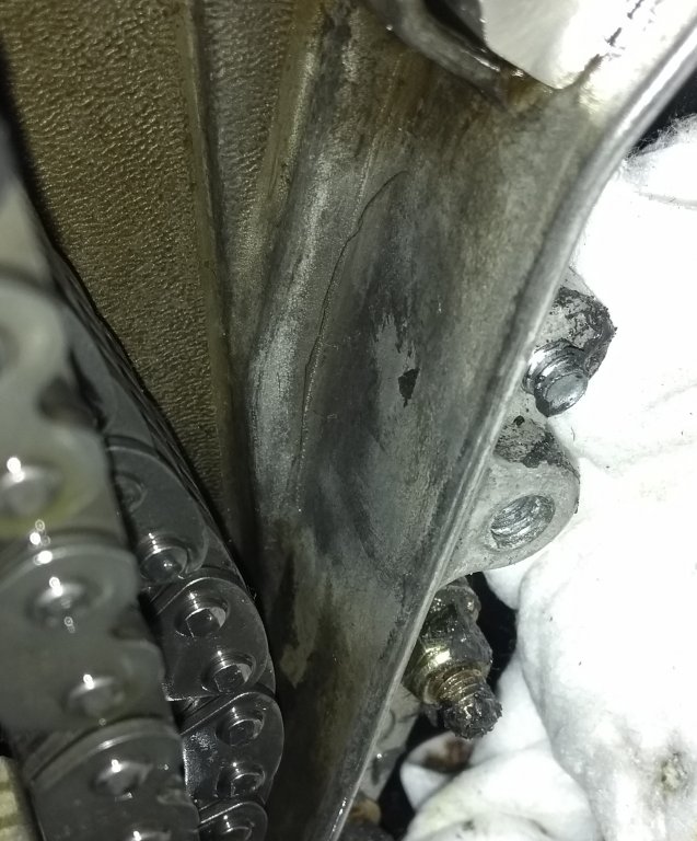

I took my chain case apart 3 times over the winter as I was leaking chain oil. Put a new gasket on it and even tried gasket maker. Nothing worked. So today I took in apart looking for a crack. Once i wiped away the oil I could easy see the crack. .
No damage to the chain case anywhere so put it back together and going to take it to dealer as it under warranty.
No damage to the chain case anywhere so put it back together and going to take it to dealer as it under warranty.View attachment 139793

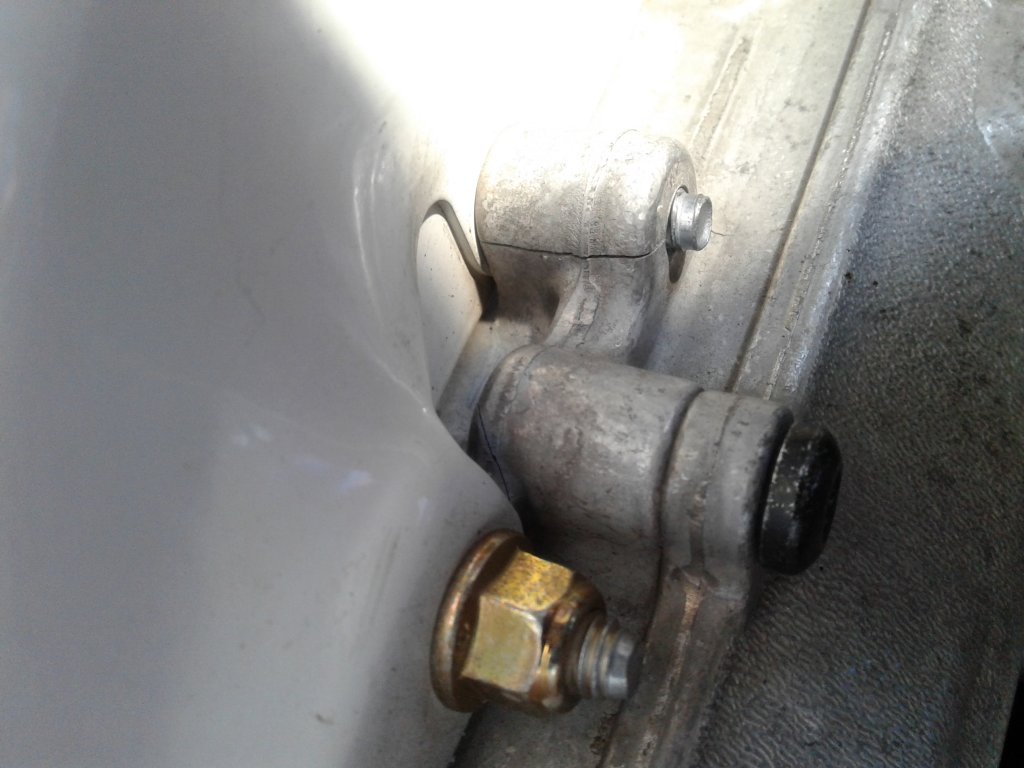

Yamaha have approved my dealer to replace chain case front and back . They found a small crack on cover next to tab and crack in back that's in picture above.
sgauthier
yap that's a known issue. My sons '17 LTX LE had to have it changed right after he took delivery of it. His buddy and brother both had to have there's replaced as well. JMO but the sooner that Yamaha distances themselves from Cat the better so hopefully they are gearing up to do just that.
