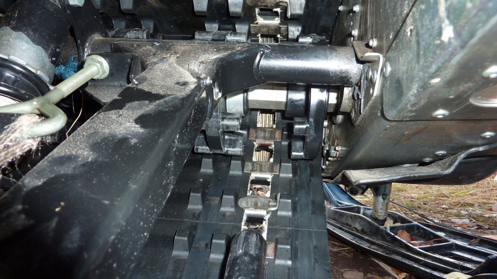

Has your right side drive sprocket shifted? I had a hard time getting my drain plug back in, which is when I realized my drive sprocket had shifted resulting in very little clearance for the bold...
JimBC
Good question - I'll have a look tomorrow. I am guessing that I should look to see if the track is centred and if the drive sprockets are in line with the track openings. Anything else I should look for?
JimBC
John B - you are so right. You can see in the photos that the right hand sprocket is completely off the track lobes. The left outer sprocket is half off the track lobes. No wonder there was no room to get the drain bolt back in.
OK - looking in the shop manual the sprockets are simply pressed on. So does anyone know how to move the two outer sprockets back into alignment? John, can you hit a home run twice?
JimBC
Today I tried to move the outer sprocket using a crow bar and then hammering in small plastic wedges. Didn't move at all. If anyone has a suggestion I'd be very grateful.
