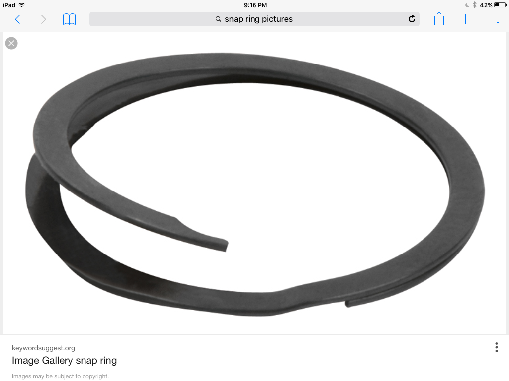

Pstn head
If it's this type of snap ring with a small flat screwdriver find the end and pick it out, then it'll come free of the slot sorta like a slinky.I just ordered those bearings on eBay. Prices where good.

It isn't a coil like that, but it does have the tapered edges. I can't pull the end out far enough to get it to unseat. I've tried needle nose players and a flat head screwdriver. No luck. I'm also scaring up the housing which makes me nervous...
canadianhunter
Some time ago there was discussion about these snap rings. From memory they said you have to work on them till you get them out and then drill your own small holes for the next removal.

Theres a special type of pliers for taking them off.
I gotta look for the name of them

Flat tip retaining ring pliers.
Mcmaster carr, or most decent autoparts stors will have them.
But even with the correct tools they suck to remove.
I resized all of mine when they were apart and installed normal external retaining rings much much easier to work on now.

swampcat
Just get the NEW circlips, they are normal ones with holes in them.Some time ago there was discussion about these snap rings. From memory they said you have to work on them till you get them out and then drill your own small holes for the next removal.
I know this is not much help.
swampcat
They are called Eaton ring pliers. And they still SUCK. Compare a new ring to a removed and replaced ring, and you can see the difference in diameter. They are poor quality rings to start with. Update to the normal circlip. Speaking from years of messing with this overly complicated chaincase, starting in Nov. of 2011.Flat tip retaining ring pliers.

They are called Eaton ring pliers. And they still SUCK. Compare a new ring to a removed and replaced ring, and you can see the difference in diameter. They are poor quality rings to start with. Update to the normal circlip. Speaking from years of messing with this overly complicated chaincase, starting in Nov. of 2011.[/QUOTE
Just did a search. Cant find any plier called an eaton ring plier. Theres plenty of pliers with different names, just none called eaton
Can you post a link? I would love to have the correct tool for the job
