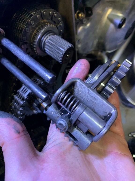

Split my chaincase as I’m waiting on new parts. Wondering if anyone can tell me this is correct. What I’m not sure of is the spring as it can go on either side. Went to put it back together and shut went fling! Thanks for any help guys. Just wanted to resemble and waiting for a top gear and new chain.

That looks incorrect to me. This is a picture of mine before I took everything out. Clean the fillings off the magnet.

I don’t know why I ask I should just go to Dans build. Thanks AGAIN.
It is all on page one of the build thread.....tried to make it easy for guys to find info. Especially when it comes to chaincase stuff, I did take lots of pics for my own memory as well.lol
