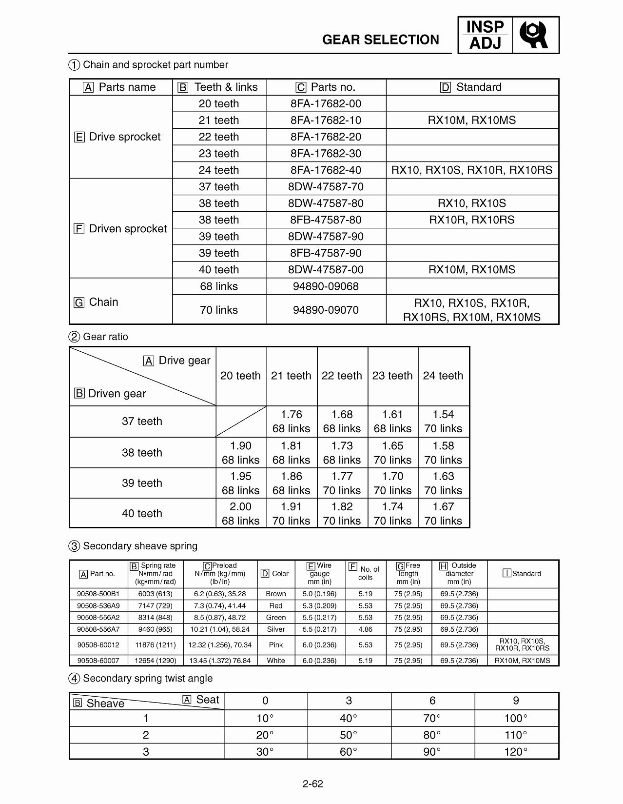

Actually found answers to all but Q#3 in the repair manual on page 78 or chapter 2-62. It has stock gearing info along with what length chain is required for each sprocket combo. Turns out the 68 link is the right one for 21/39.
So I have attached that page for future reference.
So I have attached that page for future reference.Attachments
