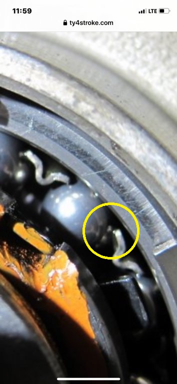

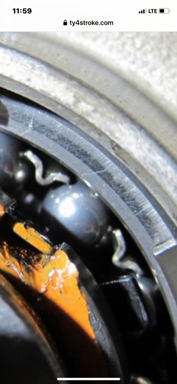

I see what your talking about now! Yes that race is definitely not tight. That bearing is junk. Good eye Clutchmaster. I couldnt see that on phone.Use some force and pull up and down, I’m sure it will clunk.
That ball is almost falling out of the race.
Here where circled. That race should be much tighter to ball.

The more I look at it I guess it could just be the shadow tho? You need to grab the shaft and pull up and down hard on it, if it moves even a little bit it’s toast.
It is hard to tell. Sure looks like it got hot and cage is loose.The more I look at it I guess it could just be the shadow tho? You need to grab the shaft and pull up and down hard on it, if it moves even a little bit it’s toast.

Haven't had a chance yet to get the collar off to double check.
If I find out that it is shot;
when removing the jackshaft does the pounding typically destroy the bearing at the secondary clutch side? Seem it would be pushing on the inside of the bearing.
It depends on how hard you have to hit it. Mine just took a few taps but some guys have literally had to cut that bearing off! Only reason I could see that happening is if bearing lock was way over torqued.
The one behind secondary won't be effected. Your tapping on the nut with orange paint on it. That's just on the taper lock.
You don’t need to remove the collar or anything to know if the bearing is shot.
Grab the shaft as it sits and pull hard up and down, if it has any movement or play it’s bad, this is the best way to check it, not after removal.
Inspection is equally important. I have seen these perfectly tight with pieces of cage bent or missing.You don’t need to remove the collar or anything to know if the bearing is shot.
Like Cdale and others have said, typically the collar will release with a piece of tubing or pipe of the same diameter is slipped over the shaft and tapped with a hammer. Mine was so tight it didn’t release, had to remove the clutch side jackshaft bearing and aluminum brace. Then remove the jackshaft out through the chaincase. Once it’s out cut through the bearing with a cutoff wheel to remove it. A real pita!
Do not heat the bearing or jackshaft to release it! The jackshaft is heat treated alloy steel, heating it will remove the temper from the steel, ruining the shaft.

I double checked with the collar on, really tried moving the jackshaft every direction with a lot of force and no movement. Took the taper nut off, and inspected it from this point checked for bearing movement, all seems good, cage seems in good shape. I think the picture was not real great. Thanks all for the help on this.
