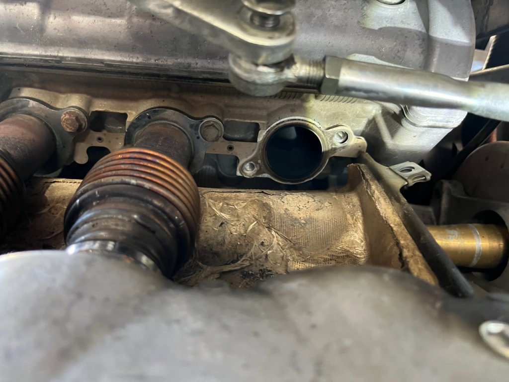

Correct. It’s sold as a kit. One donut with one stainless bolt. In my case I needed three. You can see the new donut on this picture.So that would be 3 bolts correct

My original donuts were toast

Removing the manifold was easy. The bolts that hold the exhaust tight were a pain. The head stripped. In my other picture you can see the easy out I needed to take the bolt out.
One donut was completely gone.
