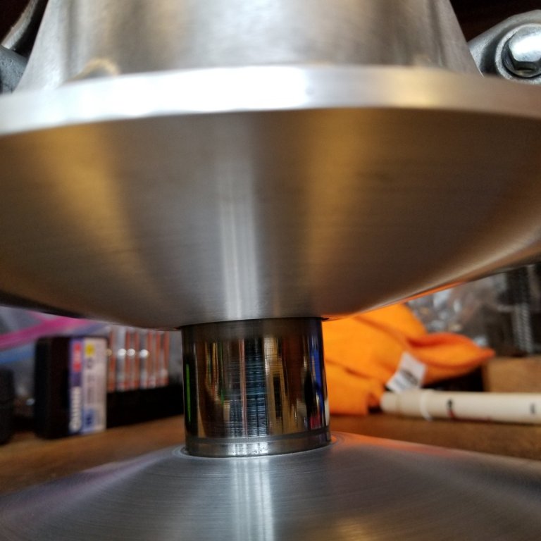

Check with Thunder Products Clutching as a post was just started with an Apex clutch that was having high engagement problems about 4,000-4,500 miles. The clutch was extremely dirty, the belt residue and debris from trail riding built up in the pockets of the clutch and twisted the plastic sliders in the primary clutch causing a very tight/clutch sticking primary clutch.
Clutch looks like brand new now!

Notice how that slider is starting to turn slightly sideways. I would put a new one on, (just the three that have the 0-ring cut out).Check with Thunder Products Clutching as a post was just started with an Apex clutch that was having high engagement problems about 4,000-4,500 miles. The clutch was extremely dirty, the belt residue and debris from trail riding built up in the pockets of the clutch and twisted the plastic sliders in the primary clutch causing a very tight/clutch sticking primary clutch.

Thanks for posting the pics. Wow, I'll have to take a closer look. Maybe that's the main problem.

My bad, I thought that was a pic of the original posters clutch.Notice how that slider is starting to turn slightly sideways. I would put a new one on, (just the three that have the 0-ring cut out).
