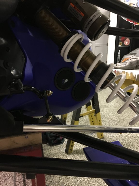

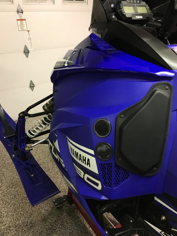

This is what I came up with. No problems yet but better safe then sorry.

what are these vents your using? looks clean.View attachment 129243 View attachment 129244

SLP, starting line productswhat are these vents your using? looks clean.
