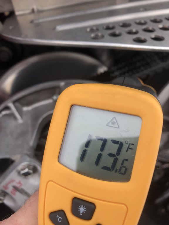

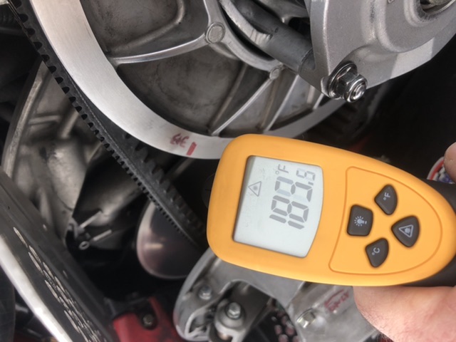

This is way way too hot!! Only one hard pass in the deep snow too!
218 belt temp. And I also corded the belt on this one run.
173 secondary temp.
183 primary temp.
Last time out If I remember correctly after 3 back to back to back pulls,
I had 145 belt temp.
Primary temp of 120.
Secondary temp of 90.
I'd consider those really cool and happy.
