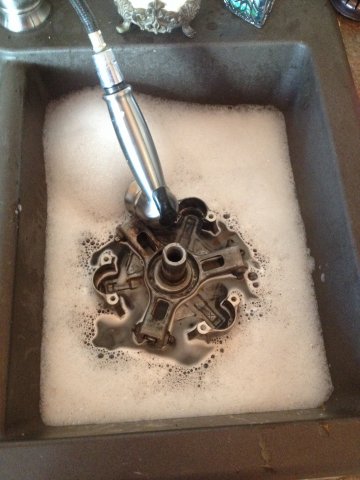

You are correct. Some have removed the bolts altogether to get the belt high enough. Side note: that belt dust can bind up your primary clutch and you may need to clean it with soap and water. Our red Viper when new ran 50 miles on a 8jp belt and had to be cleaned.
