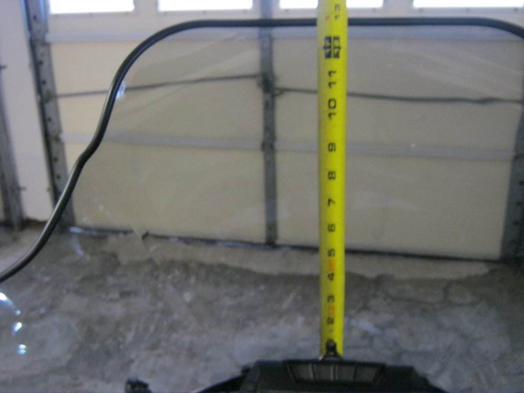

I am a big fan of staying warm while riding especially when its in the wilds of northern Quebec. For me that comes in the form of a nice large windshield. I noticed the S-TX DX had the exact windshield I wanted for my sled but wasn't real sure if it could be installed with minimal modifications. After looking at the parts breakdown for both sleds it seemed very possible and I ordered all the parts. First off other than ordering the parts which I will list there is no mods what so ever needed to install this windshield. What I don't know is if the windshield will also fit prior model year Vipers. Ok so here are all the part #'s
Windshield 8LJ-K7210-00-00 parts breakdown will list this as Windshield comp (comp is short for component not complete) you will receive only the windshield no other parts
Rubber windshield fasteners 8LJ-K7223-00-00 you will need 2 of these I ordered these but they were identical to some old Polaris and Ski-D00 ones I had laying around.
Right hand windshield bracket 8LJ-K7222-00-00
Left hand windshield bracket 8LJ-K7222-10-00
Bracket Bolt 8LJ-RA239-00-00
Bracket flange nut 8JP-RA363-00-00 You will need 2 bolts and nuts, one for each bracket
I also ordered some plastic insert nuts just to be safe, it doesn't take much to strip them out. You don't need these but I like to be prepared.
Plastic Insert nut 8JP-RA373-00-00 If you want to replace them all you will need 6
The total was right around 175 before ordering the factory Yamaha windshield mount mirrors. The windshield has the holes predrilled and mirror mount is straight forward. I will post some pics of the installed windshield along with some of the attachment points. The parts break down is listed in two different spots if you wanted to see the illustration. The first section is the windshield and the other is under the title instrument panel.

Snowfreak47
As a side note if your looking at the hardware on my mirror install I changed that out a bit. I didn't want the head of the bolt directly against the plastic. So I had some #10 3/4" stainless steel screws laying around and I removed the washer off a roofing screw because it has a rubber backing. The rubber backed washer is now against my plastic windshield. The washers have a natural concave design, a simple whack from a hammer on a flat surface straightened them out
