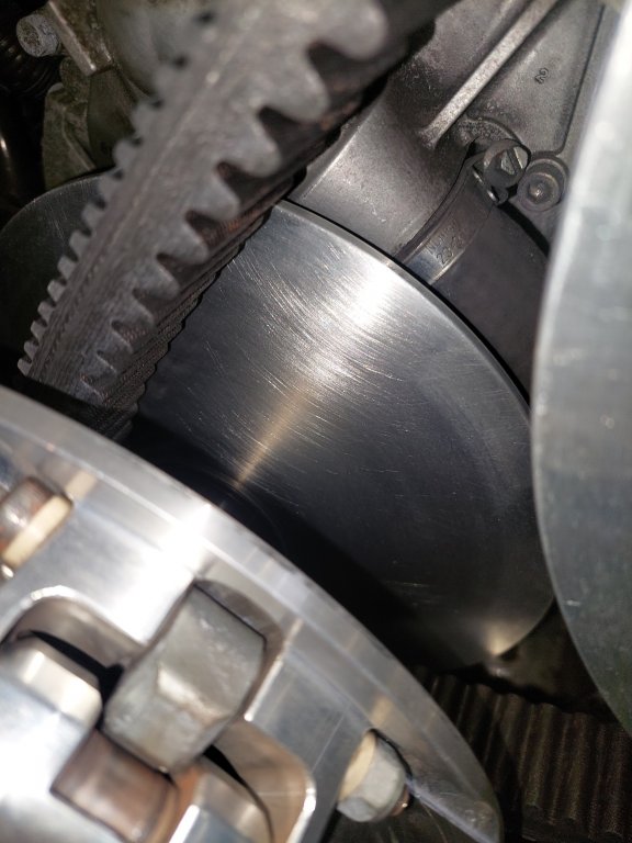

Got out this morning to test out my sled with the new clutches..
When installing I was meticulous with the whole driveline/bearing installing and clutch alignment.
All driveline bearing where installed using thermal expansion and slide right in without mechanical force
The alignment was on the high side of spec so I took advantage and honed the secondary shaft for a perfect fit (no shims)
Nice low Temps after 5 wot runs
Primary was a little warmer, probably from the radiant heat from the motor.

Looks good what kind of offset are you using with the stm secondary.Got out this morning to test out my sled with the new clutches..

What are you doing to keep your clutches so clean?Got out this morning to test out my sled with the new clutches..

I went with stm spec 2.19" (1.5 " wide belt).Looks good what kind of offset are you using with the stm secondary.

Secondary is brand new , primary was ran last year!!What are you doing to keep your clutches so clean?

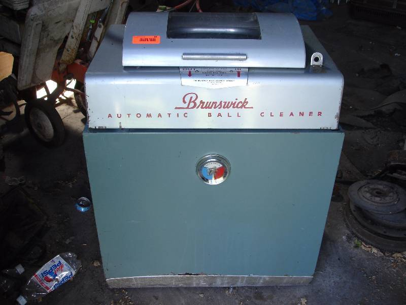

Hook the old one up in the garage? Now that would be sweet!. Your own personal clutch cleaner.Hahaha.. going to have to be very sneaky for the next little while.. new dishwasher
I was warned...hahah
Kind of like those bowling ball washers that u seen back in the 80/90's?
