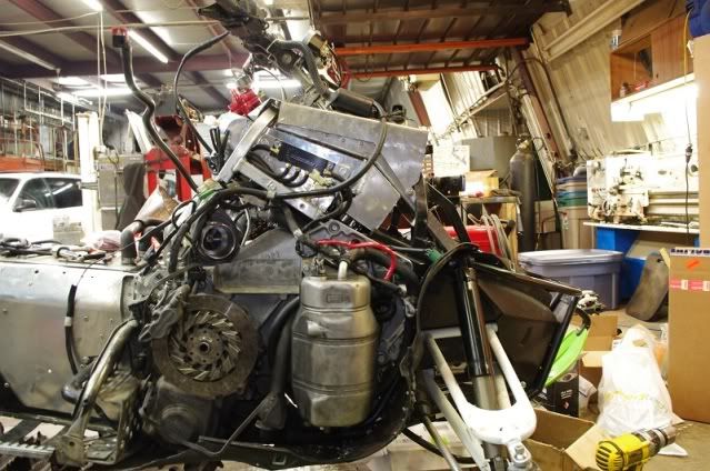

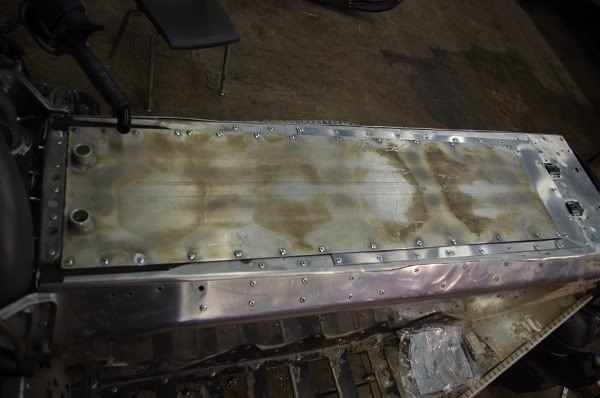

installed a tunnel cooler
t_thall

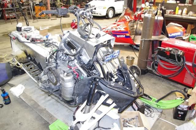

built some intercooler mounts
t_thall
started on the intercooler ducting
t_thall
sledhead162
Did u do anything for special baffling or volocity stacks in your intercooler . Nice work I do all my own work also so i know how long building a kit takes. sledhead162
t_thall
was planning on building some nice velocity stacks but i'm running so late already i just thought i'd try and get it done. Seen your sled on snowest, looks good.
Rx1M5
Where did you get the top end intercooler end tank? It looks like a pre made that you closed off. I know HKS makes them but I haven't found a dealer. What are you doing for a fuel tank?
Rx1M5
Rx1M5
t_thall
an ebay retailer, just-intercoolers maybe? can't remember for sure but it was way cheaper to buy a premade one with the right size core and modify it than it was to just buy the core alone from other retailers.

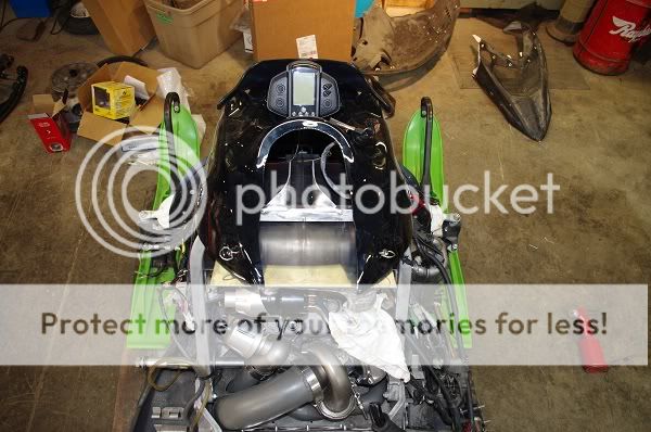

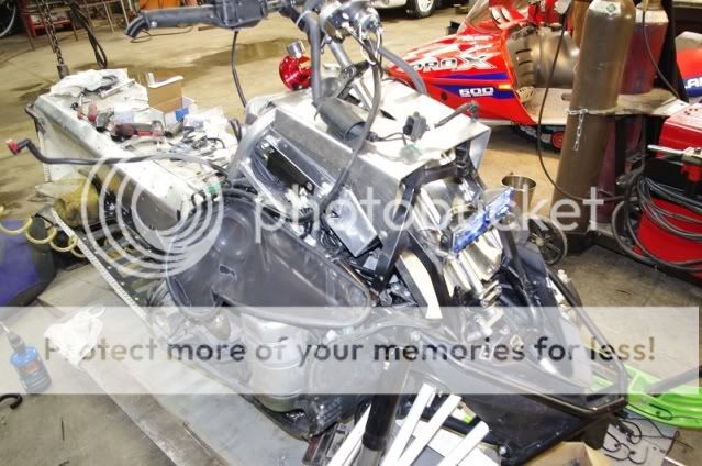

t_thall
Intercooler ducting is done, got the tunnel cooler hooked up, air filter is done, just gotta wire the new gauges in and mount the fuel tank! gonna run the stock tank moved back till i can get a custom one built.

t_thall
Finally got it all together (with a seriously botched seat cover) and got it broke in. Just at 8-9 psi so far but it seems to pull pretty hard, response is faster than i expected, might have to try the .86 exhaust housing as it is pretty much always boosting, good for boondocking but it would be nice to be able to cruise on the prairies here.
