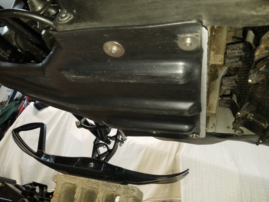

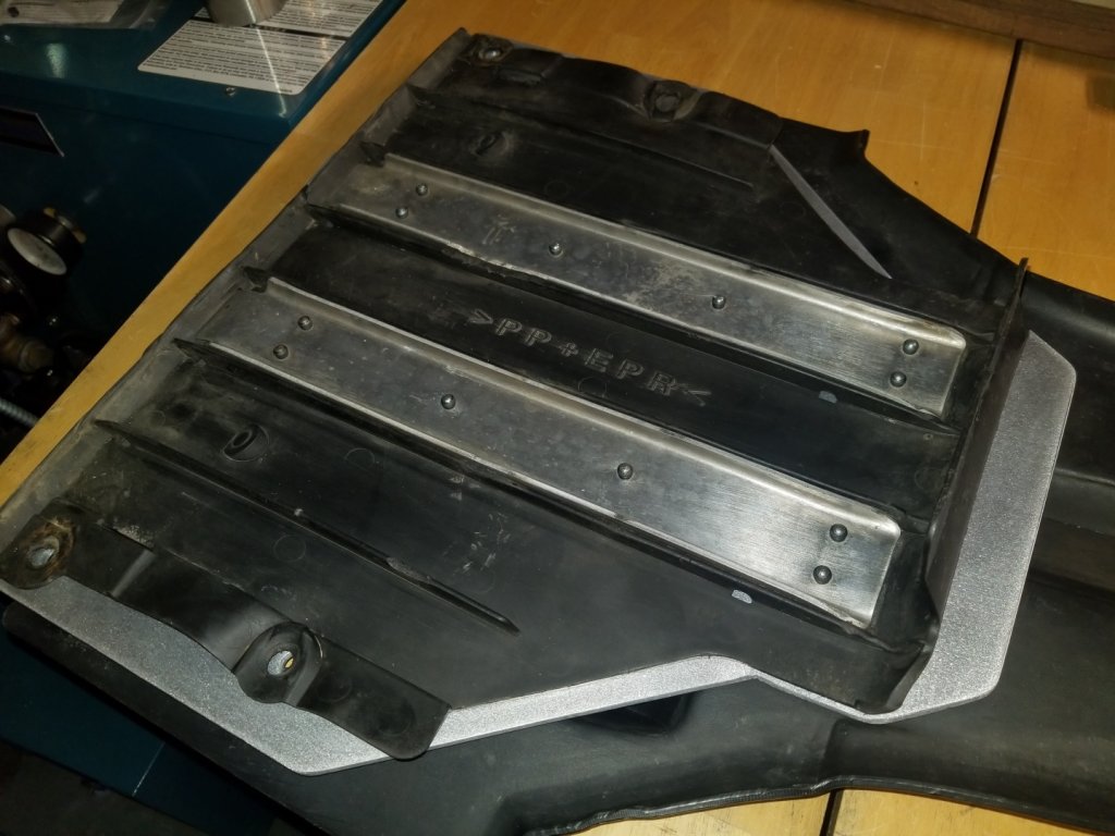

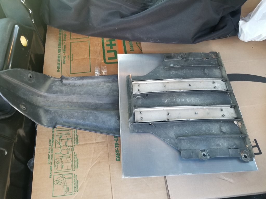

Been 2 years since I did my "temporary" $5 DIY skid plate! I went w 3/16" alum vs steel to save weight, plenty tough, I have bounced off a few stumps. I posted the entire process on page 16 of my Nytro front end plus thread but a few pics below. I sandwiched aluminum between stock plastic stock belly pan and plastic skid plate using longer SS screws. I replaced the nut sides w clip ons nuts from Ace hardware store, rugged and low cost. If I were buying one, the Mountaintech full skid plate looks sweet.
