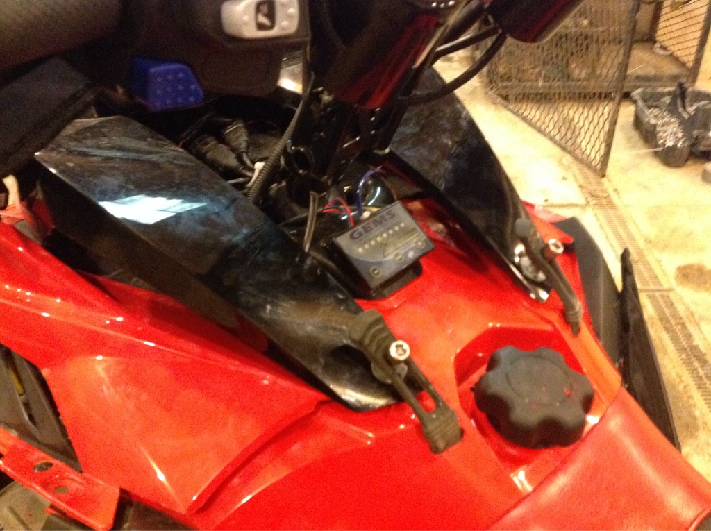

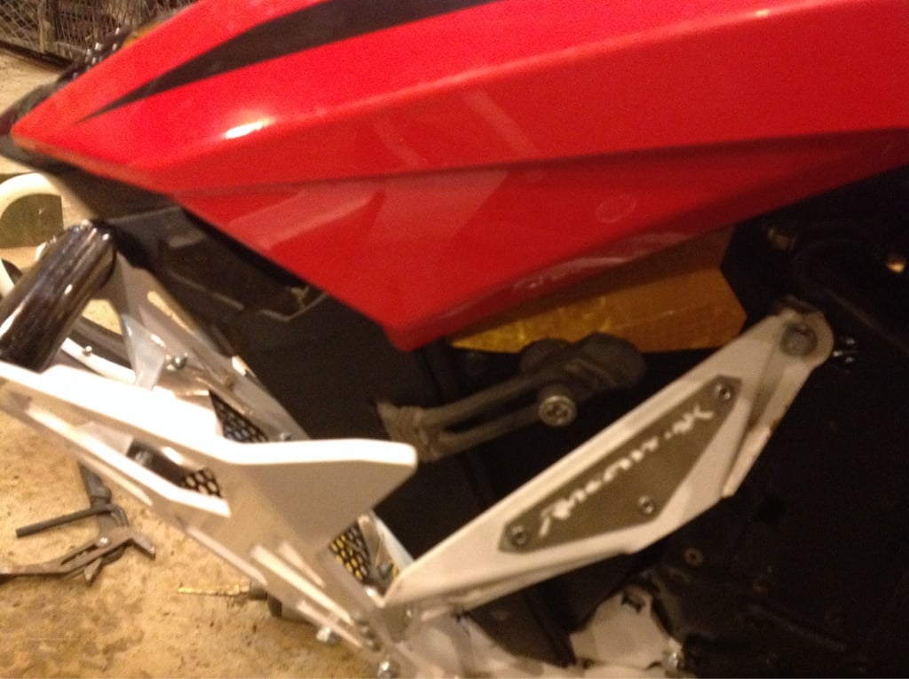

hope this video helps, removing the hood is a simple task that takes less than 5 minutes.

Great job on the video. This is what I did to mine just to make it easy and quicker for me.
