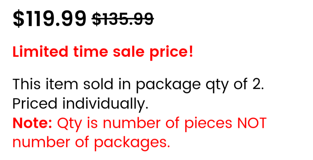

Check that price on 440-09105 at Country Cat again.... It looked to me that the price was EACH, sold in a pack of two, so $240 per pair, not $120.

Country Cat site shows p/n 440-09105 as superceded to 6639-448. And, Cat calls their own slides Tiger Slides. Cat does still sell Vespel brand. Tiger Slides show priced at $120 per slide! 8639-422Arctic Cat now sells Vespel Slides for $120/pair. Part # 440-09105

GR8BBQ......You are correct on the price. Local Cat dealer needs $160 each or $320/pair plus tax for the Tiger slides, which are white/black. Not sure I'm crazy about this color scheme?Check that price on 440-09105 at Country Cat again.... It looked to me that the price was EACH, sold in a pack of two, so $240 per pair, not $120.
Yamaha dealer is $84 each or $168/pair plus tax for the older all black ones. Looks like this is the better option.
