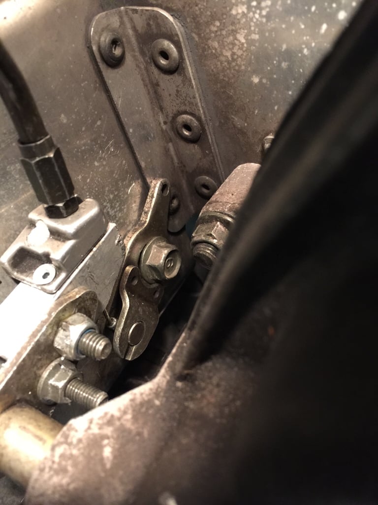

Next up will need to remove our chaincase to make things easier. You need to mount the cable end piece to the footwell. Mount the center of the hole about 7/8" from the rivet in the footwell:
The end should look like this I just used a small bolt and lock nut. Also notice the wing with the little hole in it is resting against the rivet so it doesn't rotate:
