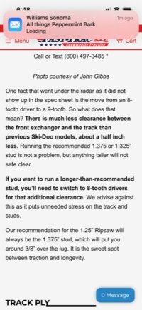

Good find! Lol. They don't need longer studs to go fast. But might need them from the dig. They'll figure something out, as we always do. I got my own problems to work on....lol.Well the 850 turbo dreams of a lake racer have vanished. Like consuela would say on family guy, traction, noooo no traction here.

No but to run with a sidewinder down low is its chance. And having to change drivers and tracks to do it on a 23-24k sled just to use it as intended. It will always be a weapon on trail but meth tank is for lakes/fields not trail. And for trail weapon it would want 1.5” with studs which is also not doable.Good find! Lol. They don't need longer studs to go fast. But might need them from the dig. They'll figure something out, as we always do. I got my own problems to work on....lol.

That report on clearance is false...go look on Dootalk. They added clearance at the front of the bulkhead to be able to run the 9 tooth driver, one guy swapped in a 1.5 rip2 with 1.575 studs at the dealer - this was dealer recommended and installed. 68Gmc is doing even longer studs (he has highly modded sleds, both from doo and Yamaha). So they will be able to get traction for sure! Much better pics on Dootalk.

Yes if they swap to an 8 or 9 tooth driver they can. Without it they cannot. Says right in your story, swapped to 9tooth driver.That report on clearance is false...go look on Dootalk. They added clearance at the front of the bulkhead to be able to run the 9 tooth driver, one guy swapped in a 1.5 rip2 with 1.575 studs at the dealer - this was dealer recommended and installed. 68Gmc is doing even longer studs (he has highly modded sleds, both from doo and Yamaha). So they will be able to get traction for sure! Much better pics on Dootalk.

They now COME stock with 9 tooth drivers, its only the XRS850 turbo that has that driver. No swapping needed...Yes if they swap to an 8 or 9 tooth driver they can. Without it they cannot. Says right in your story, swapped to 9tooth driver.
For the record, I love my Yamacat and dont have one of those 850 turbos, I just hate seeing misinformation.
