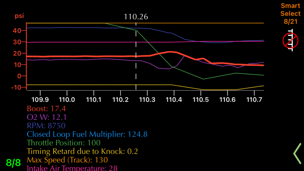

Why is you CLP at 124.8, this indicates you need your tune adjusted.... for a perfect tune, the closed loop should only have to make minimal changes. in my eyes you should richen it up on the tune and have the CLFM change allot less.... just a thought for you.Example of one of my Data LogsView attachment 173964

I think I, and others, have badly hijacked this thread....most of the guys data logging the big tunes in the colder weather are seeing the closed loop adding additional fuel at full throttle. I think with the headers, big free flowing mufflers, intake mods ect these sleds are making bigger power in the colder weather, more then the fuel systems are able to respond to with stock regulator hence I am adding an adjustable fuel regulator to bump up the fuel pressure. When just cruising the trails the data logging indicates fuel being pulled most of the time.Why is you CLP at 124.8, this indicates you need your tune adjusted.... for a perfect tune, the closed loop should only have to make minimal changes. in my eyes you should richen it up on the tune and have the CLFM change allot less.... just a thought for you.

The CL multiplier will only add or subtract fuel to achieve the desired preset AFR at any given tps position/rpm, the adjustable fuel regulator will help a little but your injectors will only flow a max amount of fuel based on the pulse width.... for it to be adding that much fuel from what the tune is saying means the tune is set to lean in that area of the map and the auto tune is trying to tell the injectors to stay open longer to reach the afr dictated.... you would much rather have fuel pulled then added... or not being able to add enough.... thats when bad happens.lol

May not be the tune , could be a fuel delivery issue. Also the closed loop as far as I know will only add 125 percent so your at its max .
What AFR were u targeting ?

That data log was on the flat groomed trail on the lake and those speeds are being achieved with a 141 x 1 3/4" track!Or going downhill on railroad grade or road?
The sled is obviously making big power and actually data logs as high as 20 lbs boost at times.
I also don't think its a tune issue, or the Closed Loop would not be adding so much fuel, and I agree the sled is having trouble supplying enough fuel for the Tunes target AFR.May not be the tune , could be a fuel delivery issue. Also the closed loop as far as I know will only add 125 percent so your at its max .
Looking for a target AFR in the mid to high 11s

U have to set your target . Do you have the stock pump still ?
I doubt its the tune . MAP sensor ? The actual AFR in any case is too lean. The injectors are getting there as they are adding tons of fuel in correction for the actual AFR reading.
Hurricane high output pumpU have to set your target . Do you have the stock pump still ?
I will start the season with a new O2 sensor as well in case it is sending false info.I doubt its the tune . MAP sensor ? The actual AFR in any case is too lean. The injectors are getting there as they are adding tons of fuel in correction for the actual AFR reading.
