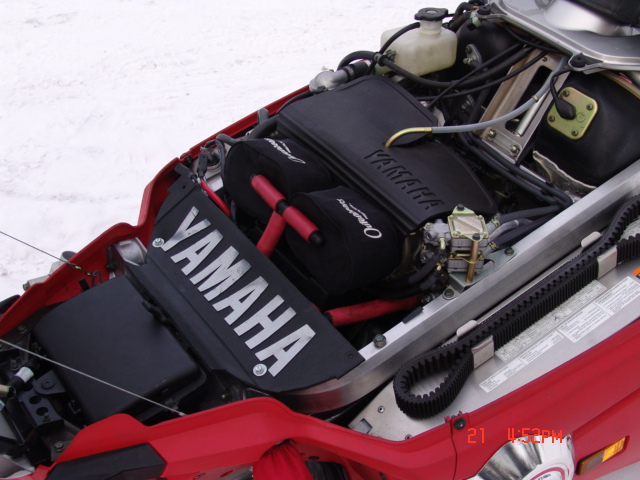

That combo worked really well on my 04 Warrior
Run your Evac back up into the catch can as it is maintaince free, I ran mine down and had to drain it when I stopped so it wouldn't freeze up. An old Yamaha snow flap also helps hold the heat in there.
