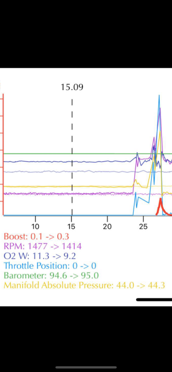

Hello. Got a major problem with my sled, several hour for searching for the problem but no. My sled went really rich overnight, went from 11.5 to arround 9 on idle. It just like ecu gives him extremly more fuel all over. Arround 9 on wot also. No errorcodes, sensor reading fine in logs, timing and valves are checked. This has happend before and then he came with a fault code on «dual generetaor lower fault» map sensor in front. Couldnt delete the code so changed the ecu last time and fault code was gone and sled was back on over 11 on idle. No fault codes this time. Can something mess up my ecu? Cant understand why its suddenly there again. Have also tryed different flashes, but all the same. Cloosed loop went from 95 to under 70 just to get to target afr 11.8 on wot. Thankfull for every tips i get. Sled running poor and have black smoke.

When you key on the sled before starting, what is your boost reading? Looking at log above idling it seems like its .1 is that accurate or has it changed with the issue? Log above appears to look fine with A/F. Can you show a log with it acting up?

Arround 0.1 in boost with key on. The picture comparing one when its was fine and the other when its was rich. Its TD racemap, tryed different flashes but rich on all. A little better one pumpgas tune but that iss possible a little leaner from start.
