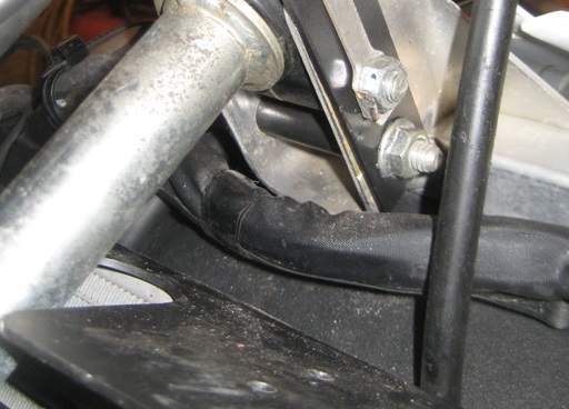

There are a couple common problems with the wire harness rubbing through. check the harness under the steering post for damage and check it behind the primary clutch (there is a nipple on the engine mount that the harness rubs on) you may have to open the harness to get a good look at the wires.

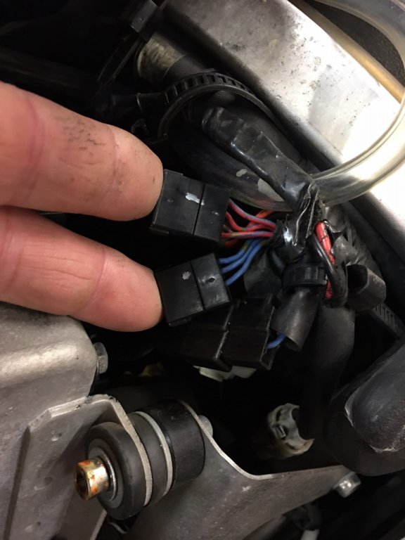

Did some more testing today.
1) ECU has all its grounds
2) Ground wire going from fuel pump relay to ECU is in tact and capable of carrying current. Disconnected the ECU and supplied ground directly to the wire, fuel pump runs.
3) In DIAG mode, tried to run fuel pump with everything connected, fuel pump doesn't run. Check engine light flashes while the "test" is being performed.

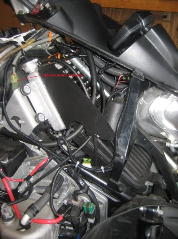

4) Inspecting the starter solenoid again, in the picture below, it says "Probe for ground signal with key in the crank position". While cranking, it seems like it's not a full connection to ground. Resistance measurements directly to battery ground show something like 1.5MOhms. Continuity test beeps though. Weird, not sure what to make of it. I have another one coming Saturday.

Blue/white has nothing to do with fuel system.
Sugarkryptonite
Thanks. So what does it do? I guess the only options are that the ECU is waiting for a signal to enable the fuel injection system from another sensor, or the ECU is fried. I have a real hard time believing the ECU is fried though since I just had the machine running a couple weeks ago before taking the exhaust apart...I had the battery disconnected the entire time I was woking on it.

The ground you probe at the starter relay comes from the key switch. It provides a ground signal to the starter solenoid to control power to the starter. That same wire from the key is spliced and that ground signal is also sent to the ECU so that the ECU detects the start attempt. Clean the connector behind the key switch (even if it doesn't look corroded it can form a white oxide layer that won't conduct). Did you check the harness rub points (especially the one under the steering post)?
