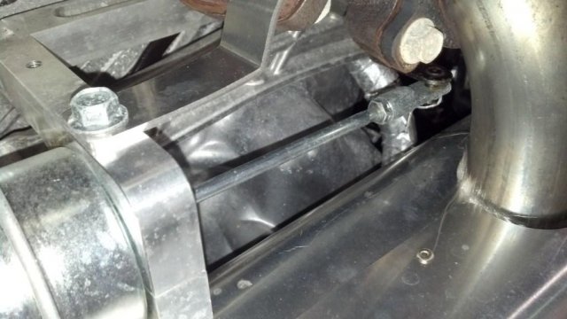

If they are saying 7.5 lbs is safe with the flash at sea level I would be happy. I just need bigger injectors. I don't believe I need a bigger fuel pump for 7.5-8psi.
I've adjusted my actuator from one end to the other.. It made very very little difference.
The spring is the only thing that made a difference... The actuator is the problem I believe.
Its difficult to take a decent pic, so I edited a couple pics together so you can get an idea..

Its difficult to get at, but it serves the same purpose. You can see the black spring I placed on the rod, at the head end it just rests on the alum bracket, and on the other end I placed a washer by the jam nut.. It got me down from 8 psi to 6 psi. I'd just like to be able to use the actuator without the spring I placed on it. Only way to get an answer it seems is to pay the big bucks and figure it out myself.

Make sure the actuator is not "binding" too, and that the boost line it isn't pinched or leaking boost any where - next step I would do is replace the actuator as the diaphragm inside may be ripped and leaking. You should be able to get boost down by simply lengthening the rod. I would try to correct the problem, not make a band aid solution. If there's a tear in the actuator it could get bigger and boost you to a even higher level. If you want more direct help you can pm me and I will send you my phone # and walk you through how to test the actuator.
I greatly appreciate your help. I've tested the actuator numerous times. I would need to check my notes to be sure, but I believe it begins to actuate at 5psi and fully open at 8psi. It also holds air. So it shouldn't be ripped. The arm isn't binding either. It operates as it should. I've video recorded all my findings and sent them to Erik in Sweden as well.. He says everything is working the way it should.. He wouldn't tell me what the AFR should be at.. he wanted everything to be converted to KPA and Lambda. I also asked if he would send me a new actuator, one rated for a lower psi. He told me the one I have is the lowest they have and they all work properly.
I will check once again that all the lines are fine. I totally went through the entire machine last year, wasted the winter tinkering with this kit.. It was not a fun time for me.. Either way, I have checked the lines in the past but I will do it again.
This isn't the first MCX kit to overboost.. Unfortunately there have been several engine blow because of overboost. I know of a dealer in New Brunswick who welded and lengthened the rods so that the wastegate would be open a little all the time.. That was the only way he could get the boost down.. He lost 3 engines prior to that.
So as it is a bandaid fix.. I'm out of options. The only way I could get the boost down was with the spring you see in the picture I posted... So to me the actuator is the main problem, and a lower rated psi actuator would solve the problem.. but apparently they don't exist.
