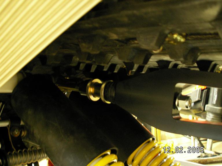

Funny you mention that nut, as it's used for weight transfer adjustment on the Snowhawk 500F. The collar and bushing in front of the drawbar on the rod are not there. Have a look at the manual, page 12-7, also good info on rebuilding the shocks.

Too bad AD Boivin couldn't supply this typ of information for the Expert X. They do seem kind of like morons when you speak to them. One thing I found was that they could give me no explanation as to why the rubber bushing is there vs. not being shown in any of their diagrams in the installation manual.
They have told me that if, following their instructions, adjustment don't work out as they say they should than I, quite frankly, must have installed it wrong. Yet the more searching and talking with guys that have one, mine is setup just like theirs. I'm certian it's not the installation.
It's just poor service with lack of knowledge on their own product and an outdated manual.
I believe removing the rubber will give a greater range of adjustment.

From what I've heard, the rubber stops it from "clunking". Probably also helps trail manners, since its like putting a spring on the transfer - less throttle, less transfer. Otherwise, gas it at all, and it'll stand right up on its as$.
