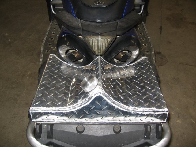

I think everyone who owns an Apex should bombard Trail Tank with emails requesting they make a larger capacity tank for the Apex. I heard somewhere that they said there wasn't a big demand for them so that's way they're not producing them.
Swamp them with email maybe they'll get the hint.

Thea best idea is JUST BUILD A BIGGER TANK.

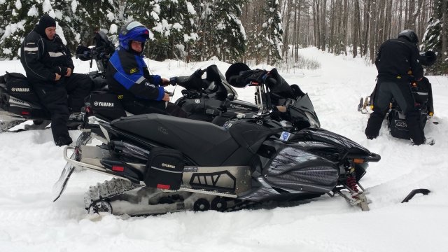

I agree with you... actually my saddle bags also work with this system.

what saddle bags are those and how are they fixed there? that looks niceFYI guys fuel caddies work great off a nytro. Will fit on any length. They do not leak when filling either. Great flexible nozzle. I know a dealer that has a couple sets for a good deal. Pm me and I can send you their infoView attachment 107185View attachment 107186

SMA-8GL73-CD-DY

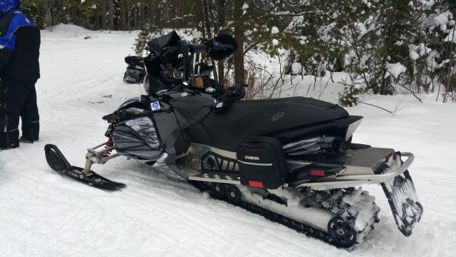

Yamaha nytro bags I cut the 90 degree bend off. Drilled two extra holes. It rests perfectly on the footboard to hold the weight then bolted it with nylocks, and fender washers on the inside of the tunnel. Works great
this is the saddle bag you can use with it still if you go on long trips. They will work together if mounted in the right spot SMA-8HG73-20-00

how do they hold on in ruff trails, and do you think they would fit on 129 inch apex?

They hold great. I used 3/8 stainless bolts. Bolt head on the outside with regular washer. Inside tunnel a oversized fender washer with nylock. That plus resting on the running boards held great. This is a 128 with a 136 extension. So where you see it mounted was in the 128 location never got in the way of my feet etc. Trust me strong. I took moguled corners and two foot woops for miles down trail 8 in munising and held perfect.

Thanks, that'll be the way to go for me then... apex 2016....ordering soonThey hold great. I used 3/8 stainless bolts. Bolt head on the outside with regular washer. Inside tunnel a oversized fender washer with nylock. That plus resting on the running boards held great. This is a 128 with a 136 extension. So where you see it mounted was in the 128 location never got in the way of my feet etc. Trust me strong. I took moguled corners and two foot woops for miles down trail 8 in munising and held perfect.
