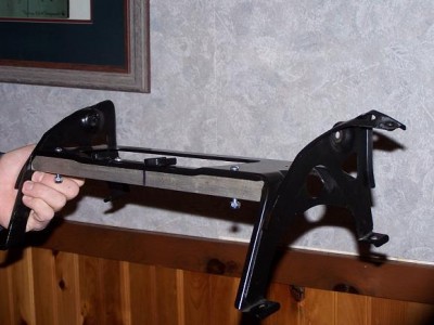

I've found it much easier to remove the entire bracket with the headlight still attached to it. 4 bolts and it's off.

Where the bracket attaches to the upper frame. 2 per side. This allows better access to everything on top of the motor. Look at this picture. The 4 mounting points are shown;
http://www.ty4stroke.com/download.php?id=29455
