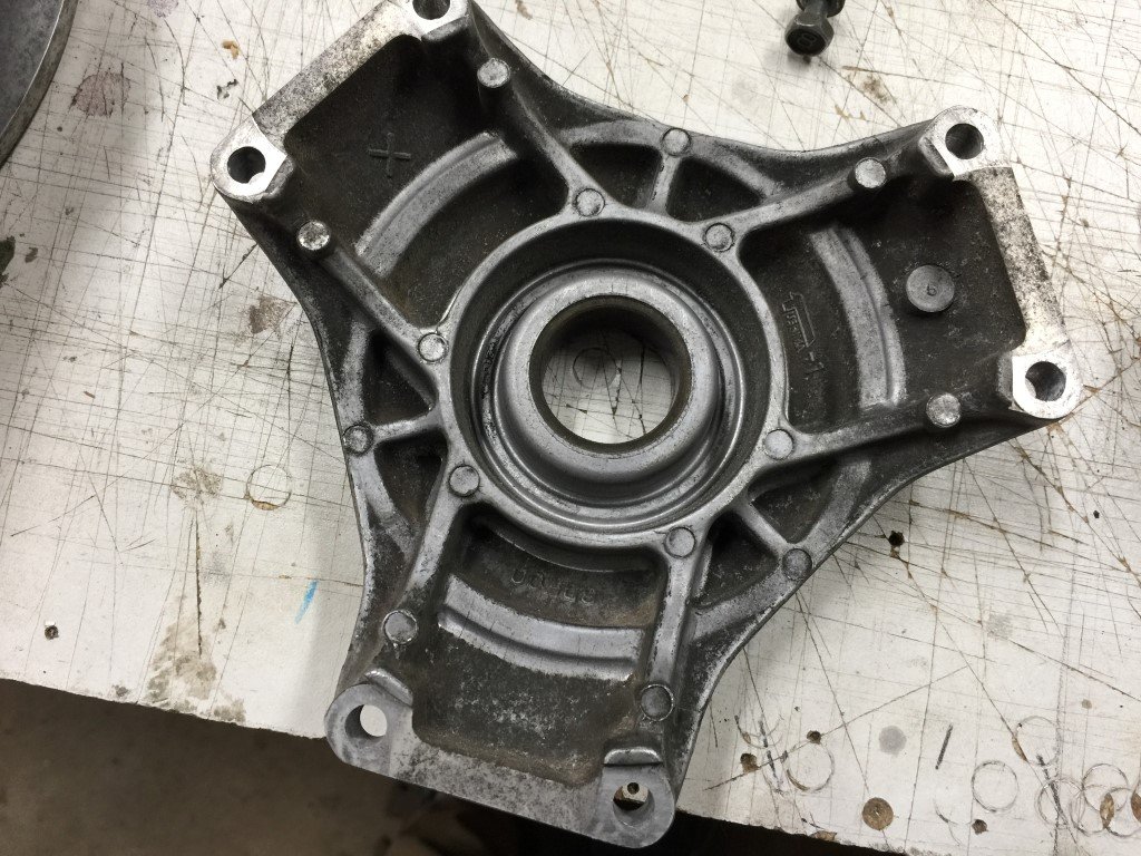

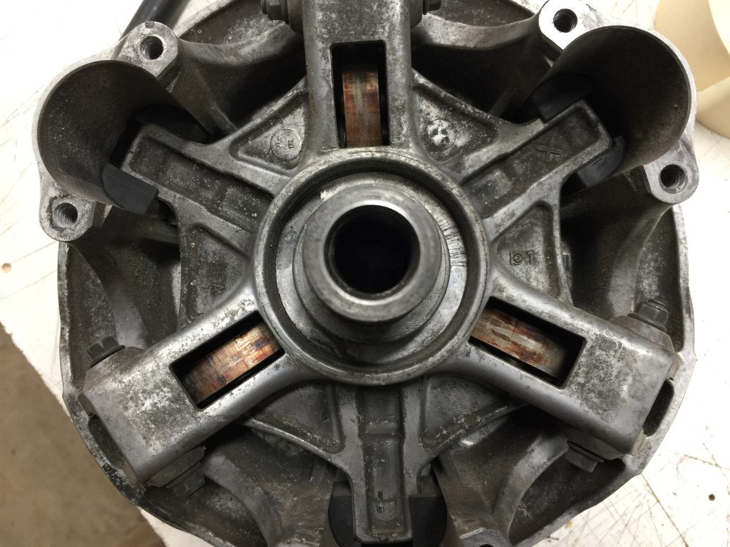

OK, here's what I've got...remember, car guy learning to talk "sled". Photos attached, Spring free length 89 mm, did talk to someone about putting a short spring in to achieve what I'm after. Rollers are tight side to side and roll free, no flat spots no holes or mods in weights from what I can see. Sheaves fine too. All looks good. Just need a spring to try.
Thanks,
Seann
Thanks,
Seann

- 8,040
- 2,133
try the spring 1st of course.
the weight you have
in picture has 3 holes in it that are filled with rivits (three circles on side of weight)
the weight you have
Took out the weights, cleaned them up each are 80 grams. "8FP 00" stamped in if I'm reading it right.
