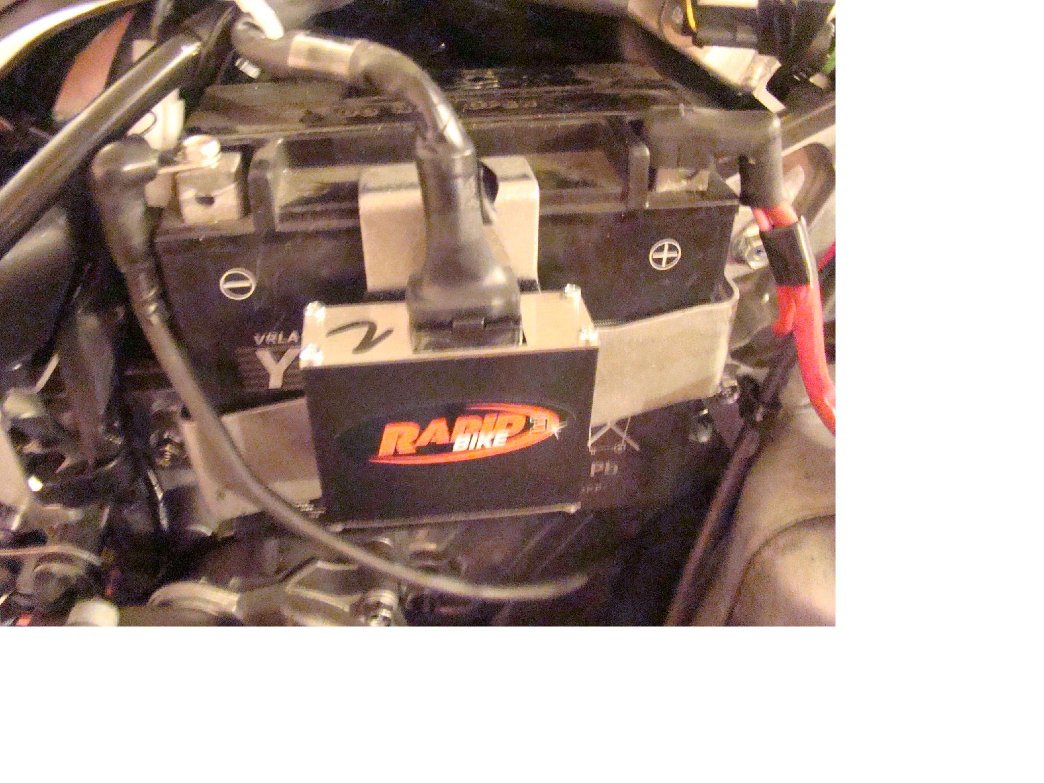

Mounty, have you had to add any fuel with the RB3 and Hurricanes map? How easy is the RB3 to install...and are you running 87 octane?
Sled Freak: I was running the track with extro's loose prior, tightend to loose side of Yam. spec.
Shadow44: Hurricanes map as is. No blurbs or backfires. RB3 very easy to install. Mounted with some commercial grade velcro.
