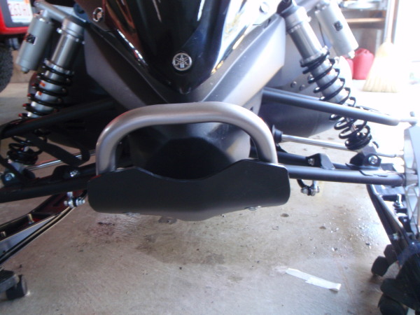

I used the flotation plate with my stock bumper. I tried it with the other bumper but I didnot like the looks of it sticking out so far. I put my original bumper on then took a hand held propane torch and heated up the flotation plate and formed it to fit up against the original bumper. Looks and works great. I used the original clips to fasten it to the front bumper.
Do you have any pics? I just got an old style float plate and plan to mount it the same way. What I like about the float plate is it provides protection under the clutch panel, unlike the stock and the Yamaha accessory skid plate.
Here are a couple pics of how I used the Yamaha flotation plate with the stock bumper.

Thanks for the pics! But they must be photoshopped because the know-it-all parts kid at Anchorage Yamaha told me there was no way to mount the float plate without buying the accessory bumper. :rofl:
A couple years ago, my buddy mounted his float plate using the stock bumper but I never saw how it turned out since he sold the sled. Seeing your pics, I think it looks way better with the stock bumper than the snow shovel look with the accessory bumper.
