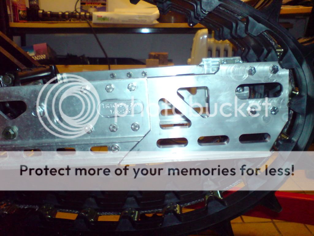

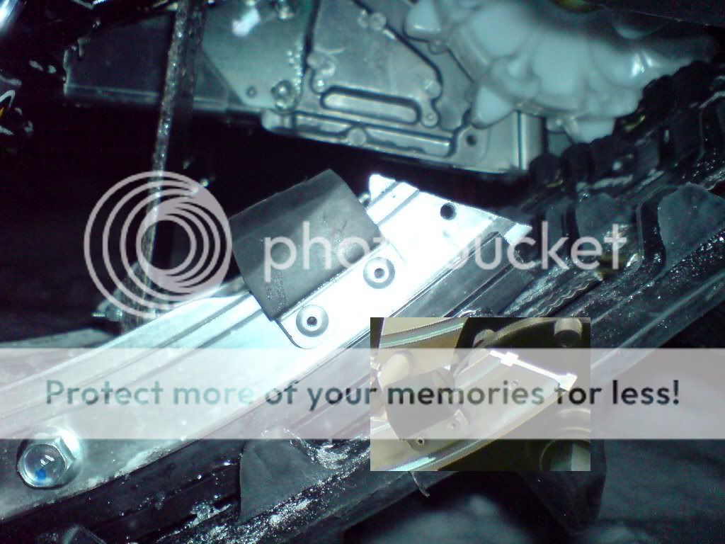

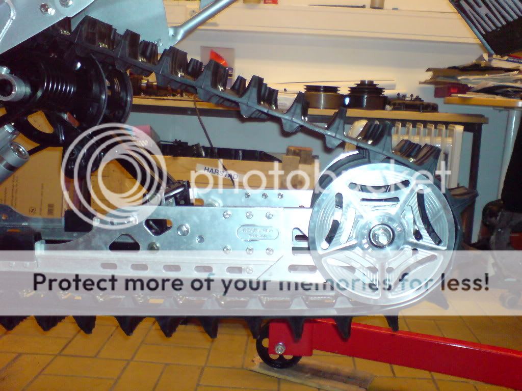

Had to cut some more of the rails. Now they just fit with as little clearance as possible to the drivers
The first cut along the red line was way off. Then I cut the green line.
I have now cut off about 25-30 mm of the rails (measured at the front of the rails) and about 5 mm off the front of the plastic protector (and a lot at the rear of them).
I also cut 5 mm off the slider runners.
Not enough space for the front protectors after first cut.
Much better after second cut:
Second cut in progress:
Comparing stock rails with the shorter ones (yes, I have to drill another hole):
Not much left of the plastic protectors:
