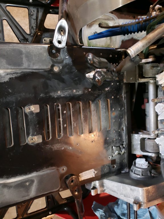

Here's some pics of mine when i strengthened the tunnel to heat exchanger.
I did not remove it.
The rear engine mount brackets are part of the heat exchanger.
Hope this helps.
