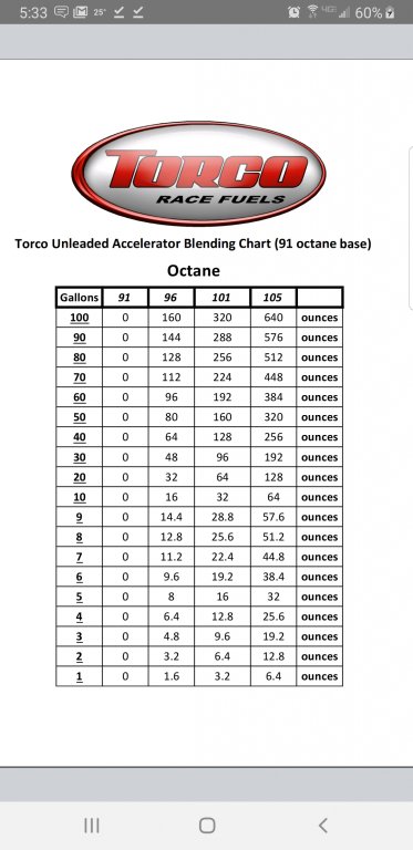

Check this out.
Too bad you dont need it with the tune you run.
This stuff really works as advertised.

Check this out.
5 points of increase for 16 ounces in 10 gallons of 91 is dam close to what you’ll get adding toluene. Actually it’s a little better with klotz because they add lead in their booster.
