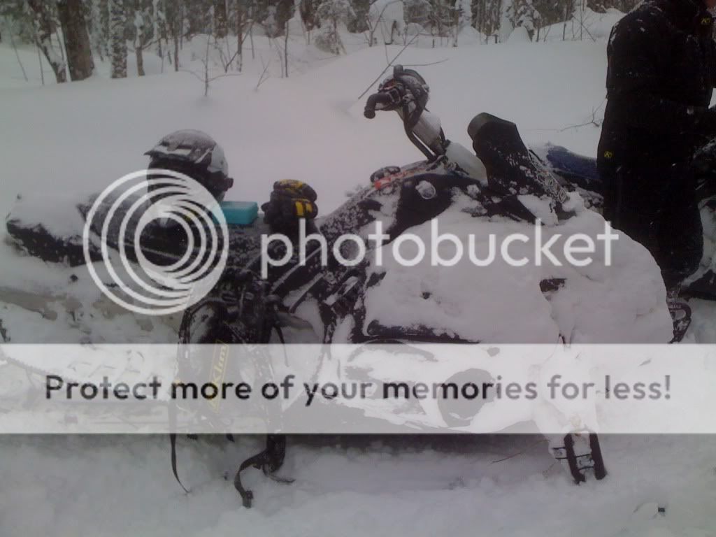

A bit tough to tell in the second picture - but i have the ones near the head light covered with screen also and the gorilla tape works great. I am also running 2cool vents on the side panels. I recently added the IP vent from OFT - this single vent made the most difference IMO. Look at the last picture. When your running in powder and it is covered with snow - where can the heat escape. I couldnt believe the heat that was coming out. I didnt notice it while riding - not like there is so much that your goggle are fogging up or anything like that. But when I would stop i would toss my gloves up on the vent and it would warm them up.
