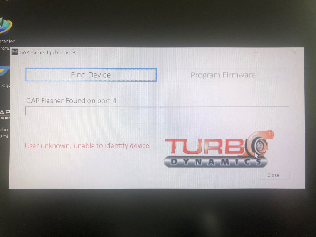

Now what?

Current firmware should be b0775
- 5,721
- 4,312
Connect the flasher then click 'find device' and it should show you what version you have.
Thanks, but why am I getting the "user unknown, unable to identify device" message?

That I can't answer. Yamamarc may know.
The gap flasher was found on port 4 which is a good thing. However when I click on "Find Device" I get the "user unknown, unable to identify " message.

PM Gap he was very helpful and sorted mine out. You may not get a response until business hours though.
Include your flashers number on back of tool to Gap.
- 5,721
- 4,312
Is that something TD would have to send through to your updater.
