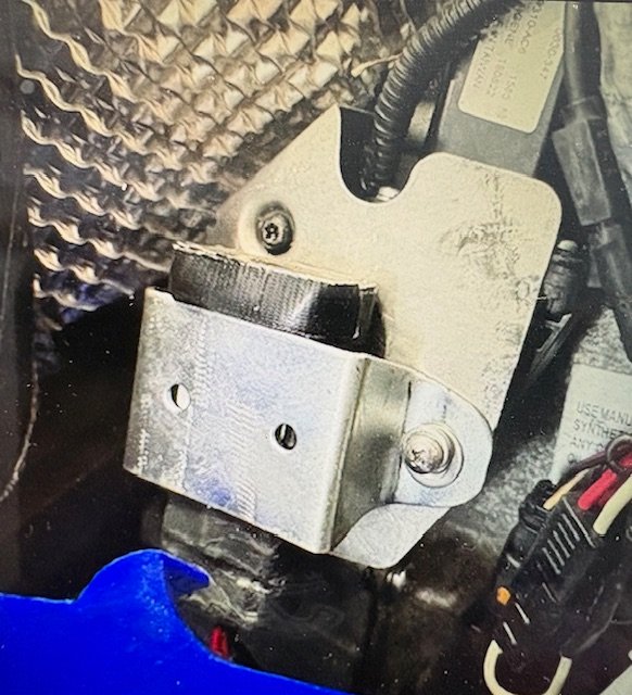

My Flasher is a mess after it drifted under the header many years ago and severely melted! Amazingly it still works but I have had to patch it up. After the melting incident I built a bracket to secure it in place better then the zip ties I used initially. Not pretty but it works for me.
