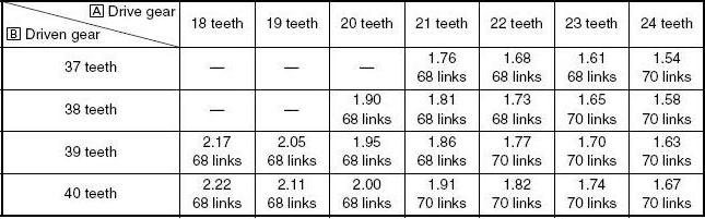

Stock gearing is 21/39 and the stock chain is a 68 link chain. This means a final ratio of 1.86:1.
If you are going to use a 144"x1.75" track also off trail, I would recommend a final ratio of 2.00:1 or higher. Dropping one tooth on the upper gear to get 20/39 will take you close, but I would prefer 19/39 or 20/40 with that kind of track. All of these gearing combos can be used with the stock 68 link chain, even if the 19/39 will put a lot of excessive chain around the chain adjuster, thus requiring quite a "turned in" chain adjuster. Changing only the upper gear is budget, changing the lower gear is...well, let us just call it slightly more expensive...
I have been using a 136"x1.75" with 20/40 gearing all winter. I can not see how I would get away with a lower final ratio than that.
See pictures below for part numbers and recommended chain. I am pretty sure you can get them from Port Yamaha, at a decent price too...
