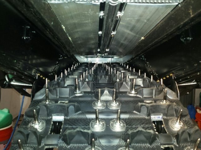

Ive aggressively studded every machine Ive ever owned and never thrown a stud....that comes from poor installation or not enough studs...heres my cat turbo's studding...lets just say if you want a powerful machine to perform and be safe..you absolutely need them...same track as the ltx-le and you can see the actual tunnel protection

You dont have the " anti vibration bump" inside of your track?
My 137" viper was a pain in the #*$&@ to stud..... Stud in the bump just DONT work for me....
I totally agree whit you ! For that power and torque, we need stud, i mean real stud ,SINGLE ply track pre-studded is just not toff enough,for agressif and high milleage trail riding........

I DO have the silent drive bumps in there!
its all in the studs you chose ....if you use a thin profile head it sucks right down flush as if they werent even there...smooth as can be..
those studs that go through the nubs will be marginally less penetration....

How many milles you did whit the track in the picture?

thats no miles...and yes Ive occasionally bent one with that kind of power...Ive used others that never bent or break though...
